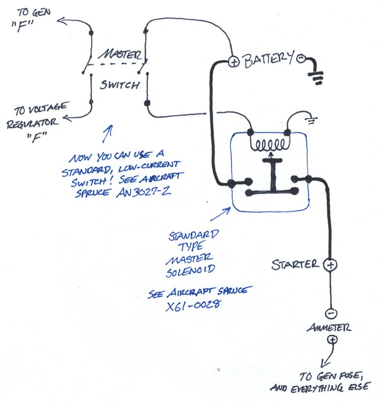

2. If your master switch is faulty or intermittent, a new high-current switch is too expensive, and the old kinda-high-current switch is, I believe, only available in new OLD stock or used. I still don't trust them. The Alpha Aviation STC is $300 and comes with all the parts needed... it removes the high current from the switch - now the switch only carries 0.8 amps to activate the solenoid, and the solenoid does the "heavy lifting" of feeding many amps to the starter.
Compared to my previous drawing, the solenoid STC changes your wiring to this:
(There's also a voltage spike protection diode in the STC kit, I just didn't draw it)
