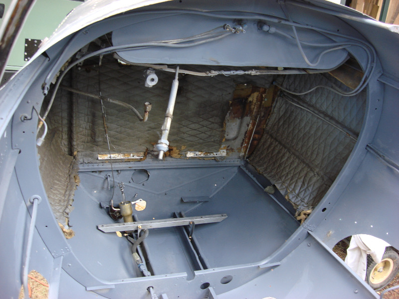

Thanks Warren. I am trying to see how to mount the yoke mast to the fuselage. I see the bottom has two holes for bolting on to the bottom of the fuselage, I see the elevator rod, but that's as far as I can figure. I can see why the pushrod needs to go on first.
Then there's some rigging to do. I will need to figure that out.
I just need some visuals to jumpstart the process.
Thank you
Thank you

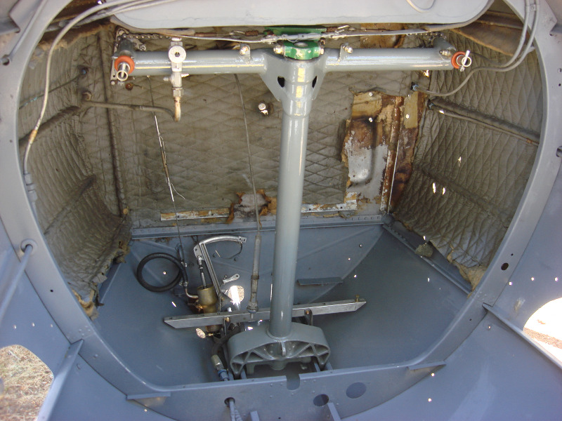

Shawn go to craigslist for Reno Nv there is an ad for a Coupe Over priced but there is a picture of a green mast. But I am confused is it a mast or control Column you are talking about. I have taken pics of the mast in my 415

One of the hardest things to do on and of the Coupe family is to get to the mast Four 1/4- 28 bolts hole it to the airframe but the cotter pins are a bitch to get to. Then the control rods need to be done first. The Coupe needed a removeable bottom like Mooney M20 have. Maybe you could do a 337 to make an Insp cover to work under the mast ( ? ) that been done under the control column. Ps see my views on the suggestion column... And then comment.

Hello All!
Does anyone happen to have any detailed photos of how the 415 control mast mounts to the airframe? I am not finding any visuals or specs on bolts, etc. Any photos, diagrams or narratives would be appreciated, as would a suggestion as to where to look. Thank you!
Shawn
