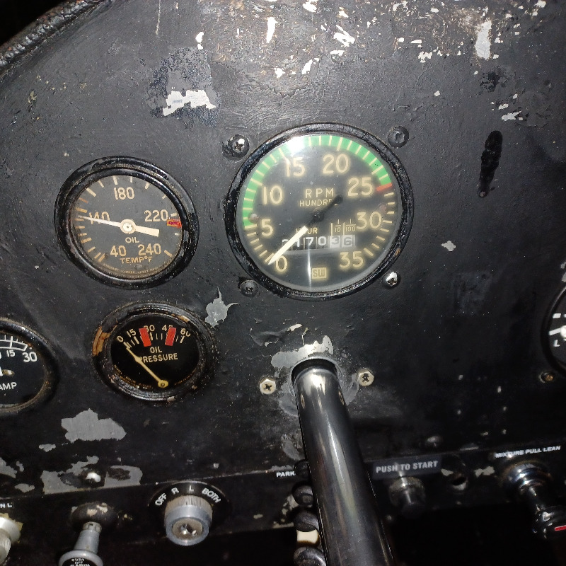

Okay, a quick update but unfortunately not the final report.
The W72GK-50;is mounted and it's beautiful. I knew that wooden props are known to be smoother due to their dampening engine pulses, but it is VERY much smoother. I was verifying my RPMs with an optical tachometer and this prop idles butter smooth at 475 RPM. The RPM also accelerate quicker, and it's noticeably smoother at all RPM settings.
On interesting difference from the old McCauley - the black back of the McCauley really disappeared above 1200 RPM. The back of the Sensenich is brighter wood and brass so there's a golden propeller arc that's a lot more visible. I don't think it'll be a problem, but this prop really let me know that it was going to be different.
Unfortunately, it also exceeds the static RPM limit. I had mentioned to Sensenich that I have not a stock c-85 but a c-85 "Stroker" with a little extra horsepower, but they still recommended this as a "cruise" prop so I agreed.
Now, According to TCDS A-718 Propellers Item 2: "Propeller with Continental C-75 or C-85 series engines" ... "any fixed pitch wood propeller eligible for engine speed and power which meets the static r.p.m. and diameter limits as follows: Static r.p.m. at maximum permissible throttle setting: not over 2100, not under 1850. no additional tolerance permitted. Diameter: not over 74 in., not under 72 in."
But I'm getting 2176-2185 on the ground. Waiting to hear from Sensenich about how to proceed. Looks like I'll be going to the 52 or 54 inch pitch but I want to hear from them.
