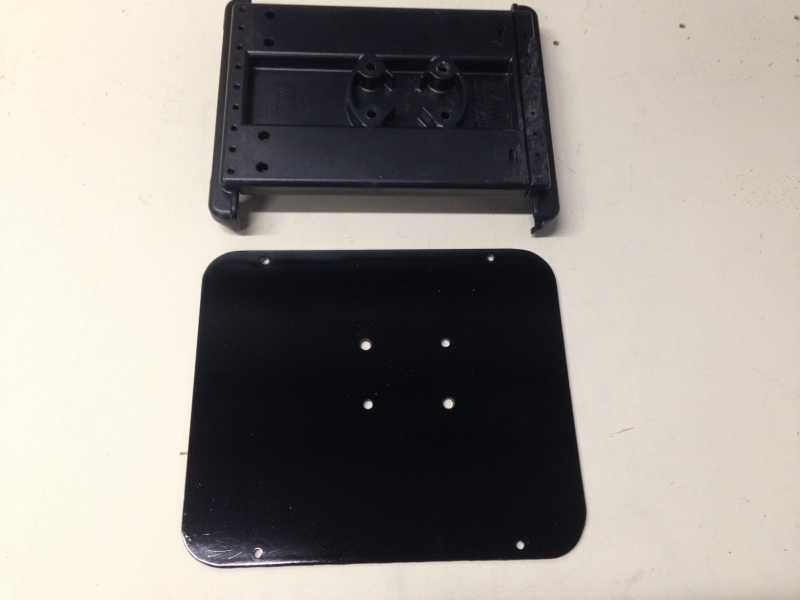

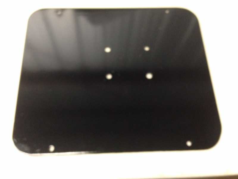

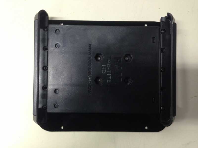

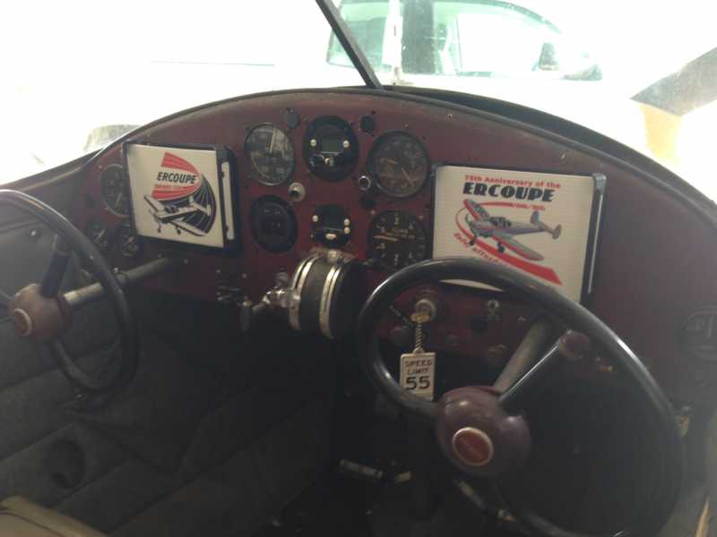

Assembled - mount holes in locations where the assembly can be removed without crawling under the dash
plate and Ram mount
aluminum plate painted black
Installed with "placeholders" in the bracket when the ipads are not in the bracket for a little pizazz. I had them made at a sign shop on platic backing for $10.
I centered them over the glove box holes.. When the ipad mini is in place, part of the tach is covered but I plan on moving the tach to the main cluster area anyway
plate and Ram mount

I am in the process of installing "Ram tab tite" mounts for my ipad mini over the glove box hole. I made a simple mod to the Ram mount to make it sit flat against an aluminum glove box cover plate. I will take some pictures today and post them here.
The mini fits perfectly.
