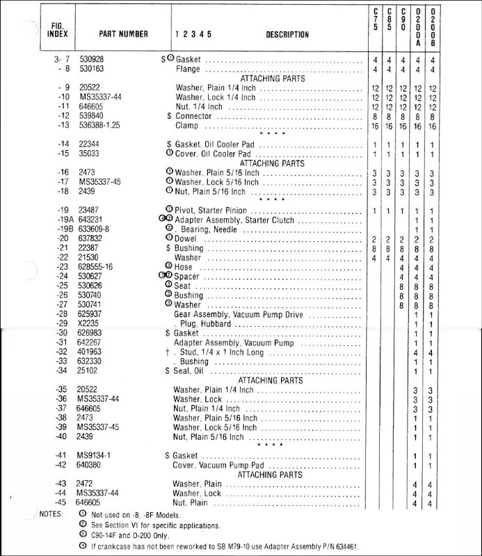

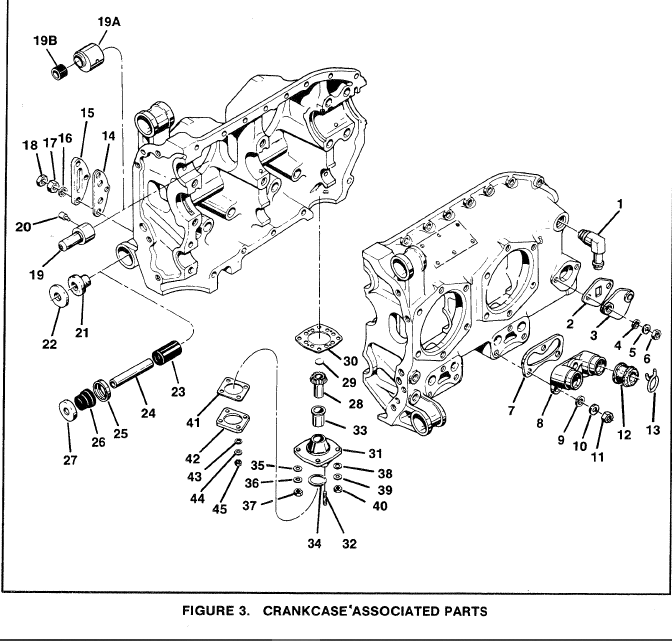

Matt, thank you for providing the continental engine Schematics and part reference numbers. Armed with that information I was able to order seals and gaskets for the generator, starter, tach drive, and oil screen from AC Spruce Canada, and receive free shipping as I also ordered tires and other stuff at the same time. FYI, I was able to obtain the urgently needed seal for the vac pump driveshaft locally and cheaply by providing them with the OD & ID info from the old seal once it was removed. The seal and new style vac pump by Rapco has already been installed.
Also, a big thanks to everyone who provided potential info suppliers of these parts. I’ll retain that in full for future purchases. Cheers all, Bob j.
