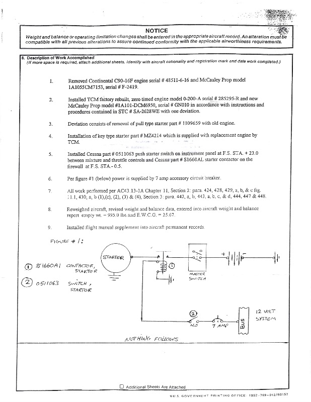

John - I'd love to see a copy of the field approval you have for that prop. Any chance you can snap a pic and either post here or text it to me?

I had a similar decision to make last year. My McCauley propeller was installed in 1994 and had almost 2000 hours on it. I decided to send it to a prop shop for inspection and refinish. I guess I'm glad I did because it failed the inspection due to corrosion in the bolt holes. Unfortunately it took almost a year to get a replacement due to lingering Covid supply chain issues. In my case I needed a DCM69/50 to comply with an O-200 field approval installation, or find a different O-200 propeller and get that field approved. I couldn't find either option, new or used, so waited for McCauley to make one.
