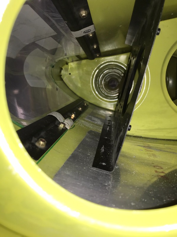

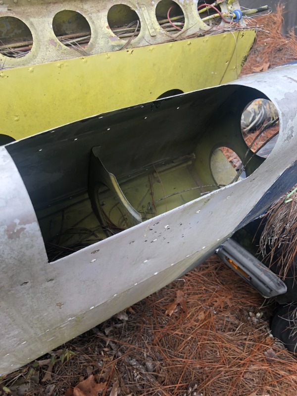

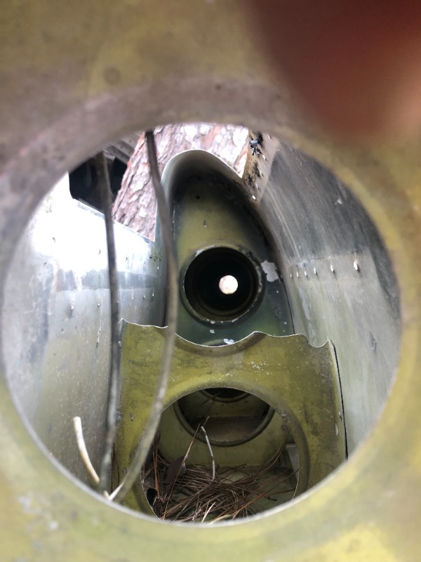

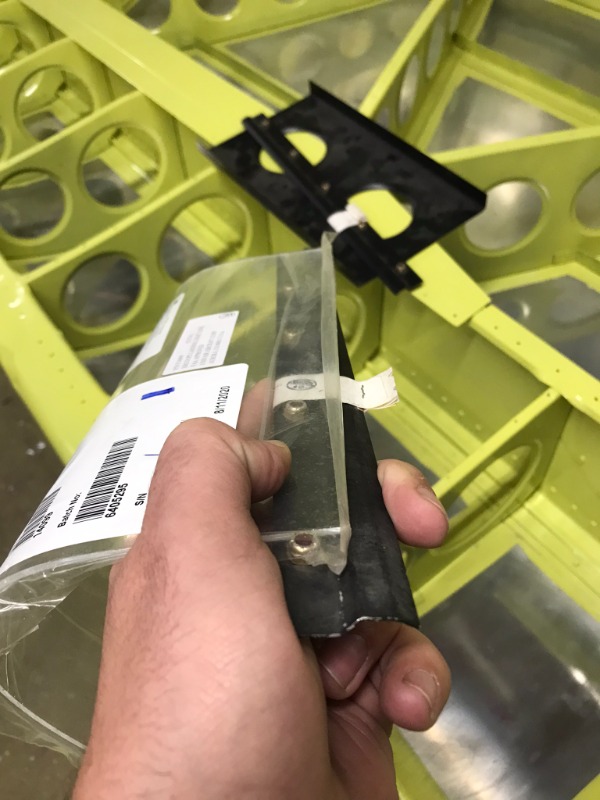

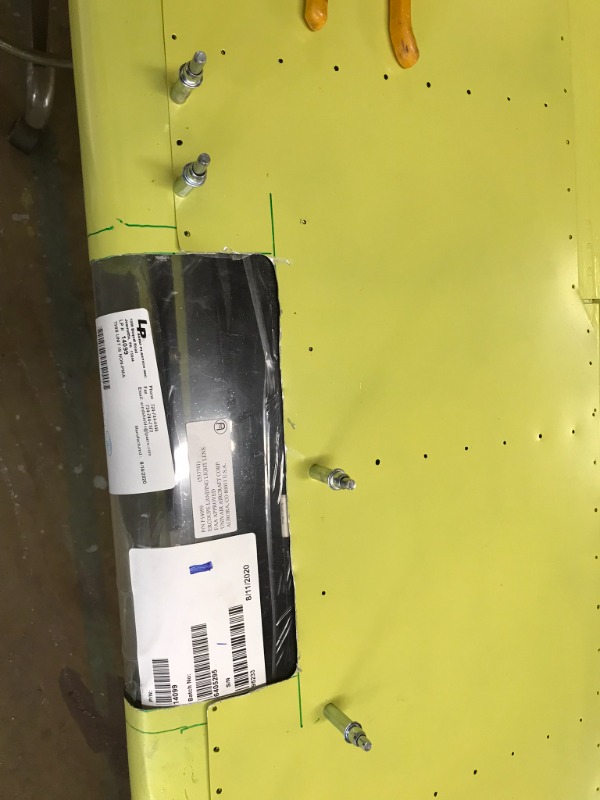

Two lights, one pair for each wing, in addition to nav/strobe lights at the tips.
Vernon did hook me up with pictures. I was able to reverse engineer based on that for both wings. Attached are the pics from vernon, and from what I put together.
Didn't want to buy the kit because I'm using Whelen leds.

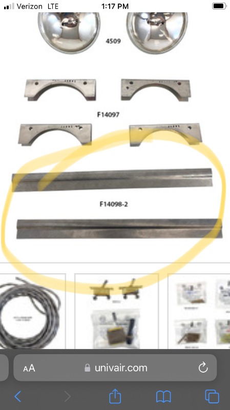

Has anyone installed the leading edge landing lights and have a copy of the installation drawings? Or, pictures of the process?
I have the wings open and have the structural parts from univair's SK-16 (FMK-16) kit but not the installation drawing. I got the structural parts and lens separate as I was going to use whelen lamps and the wiring integrates with other modernized systems. Univair won't separate the drawing (14094DWG), won't sell the drawing, unless I buy the whole kit. Which I would end up not using 50% of the parts, and the 50% of parts I need are already on-hand. Thats the end of this sob story but any help and luck would be appreciated!
