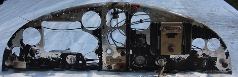

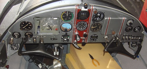

Shawn, a lot of redoes panels just cut out the frame of the panel and make a new face plate. Some add 3 " to the bottom for more goodies! PS, that panel you show is an Alone look. Forney had two panel the CD and up and the later F1a @Where they put a radio that was in the pane it's self. Ron, you did a nice looking Job on your reworked panel !! I really like the colors.

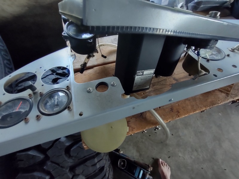

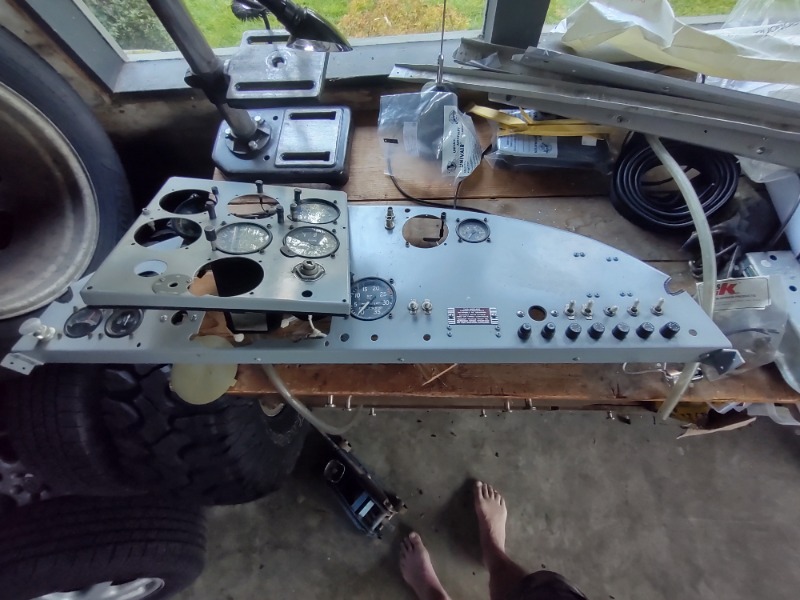

Mine started like this:
and I made this: I have since installed the second door. In hindsight, I would have made that a mount for my Ipad.
I riveted a backer plate to cover the holes, then riveted a filler plate to the backer to flush out the face. A little filler filled the cracks before painting. So it can be done. I'm not sure it is easier than starting with a blank, though.

Morning All,
My Ercoupe came with a modified panel, the one that I guess makes it look like an F1.
I'd like to go back to an original panel.
If I remove the F1-tower, there is a big hole, obviously. Can that removed portion be spliced/replaced with a flat cover, or is my only option to buy a new blank?
Thanks for your input.
