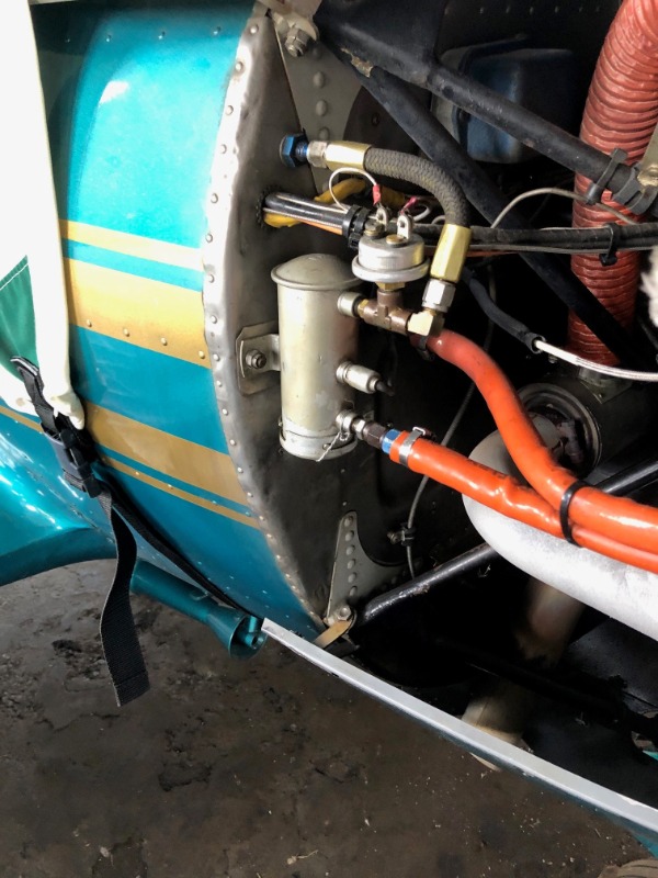

Yes, unfortunately it was never submitted. Previous owner no longer with us. it was never added to log books or 337 submitted. I want to try to compare to available STCs available to see if it was done based on one of those. If not will removed but I think it might be worth saving

If youd like I can email you a copy of the fuel plumbing and fuel pump wiring diagrams for refrence which came with my O-200 STC.

you can order a copy of your planes file from the FAA, it will have all the registration information and all the 337s that they have received(or scanned) for your plane. aircraft.faa.gov/e.gov/ND/

Engine model C-95. Dual 14 gal wing tanks. FP mounted on fire wall. Submitted a picture on post but message did not go. Don't have OKC FAA disc, sorry not sure what it is or where to get it. Reason for looking for reference installation for STC. Since do not have paper work or entry in logbook not sure which STC it is to purchase. Before I removed everything I want to find out if I can salvage by buying correct STC paperwork
