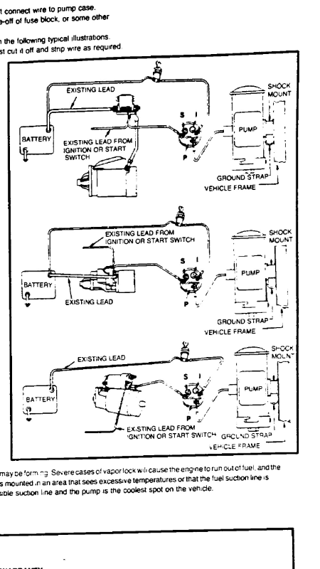

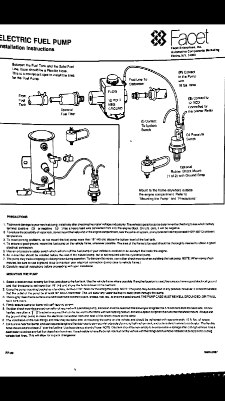

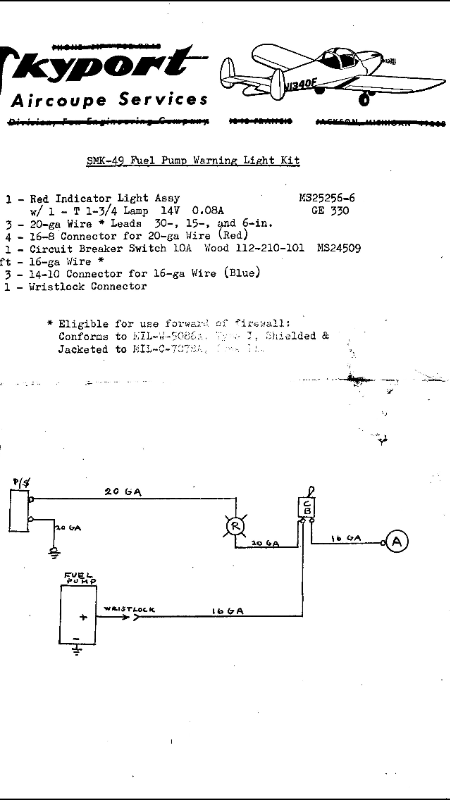

30 Jan 2020 21:39 #5
Replied by Lawson Laslo on topic Replacement fuel pressure switch for M4007-4, o-200 crankshaft electric pump
this is all I can find in my book
Photos are below
Hope this helps
Let me know if you need anything else
Photos are below
Hope this helps
