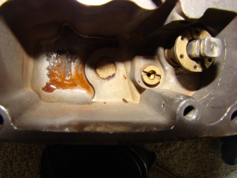

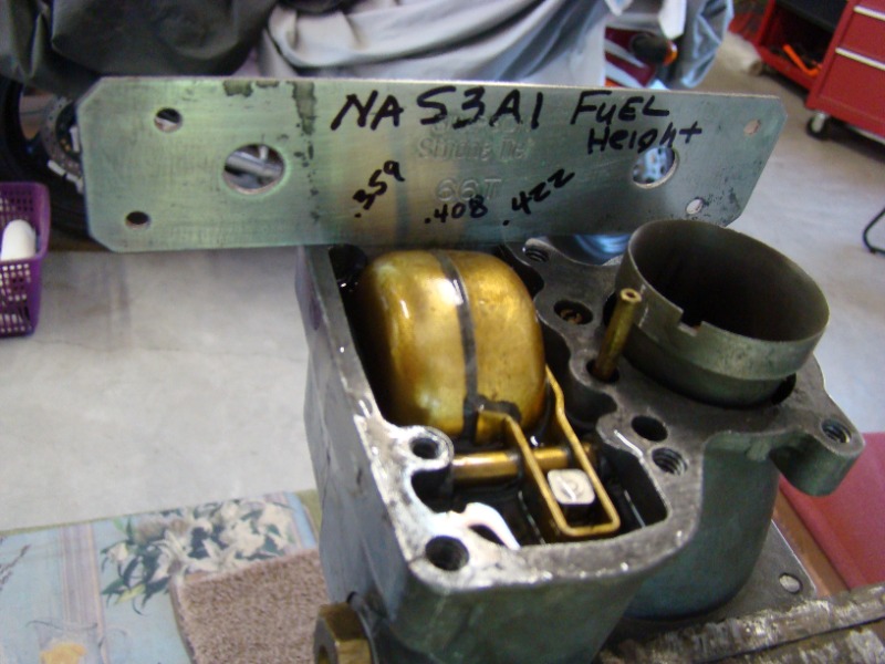

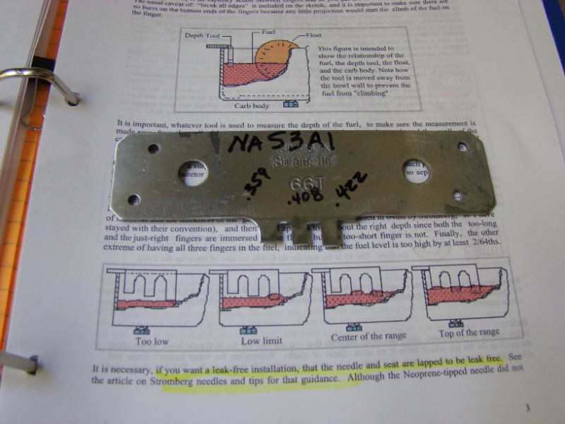

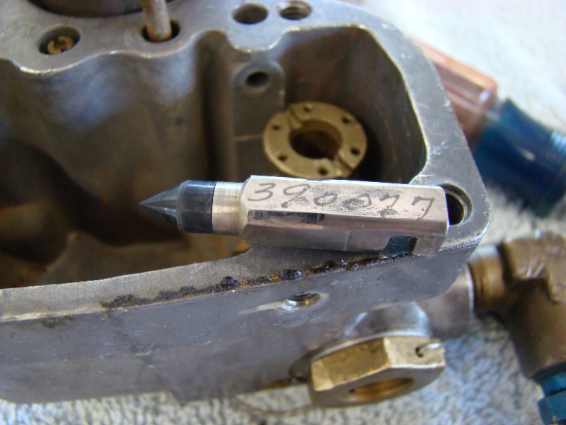

I didn't take any pictures of the screen but it was pretty clean...I sent a couple of pictures from inside the carb and the needle. I am trying to stop the carb from dripping when the fuel is turned on and the engine is not running. It is really a simple carb. My mixture control was wired shut and I am going to try to remedy the no mixture as well. There's a lot of safety wire on that thing.

I’d be curious to know if you found anything in the screen behind the big plug? Cheers,
